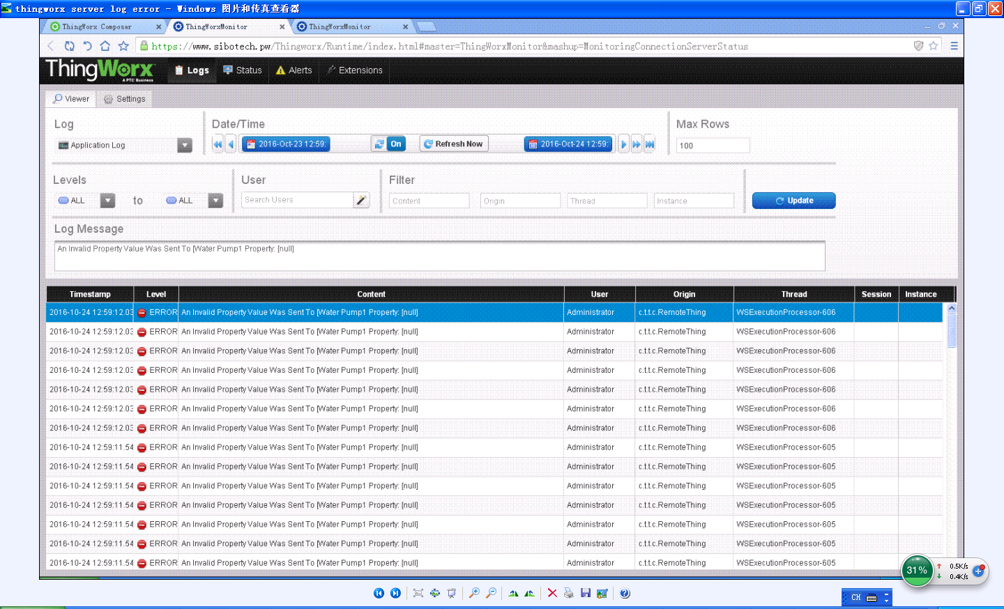

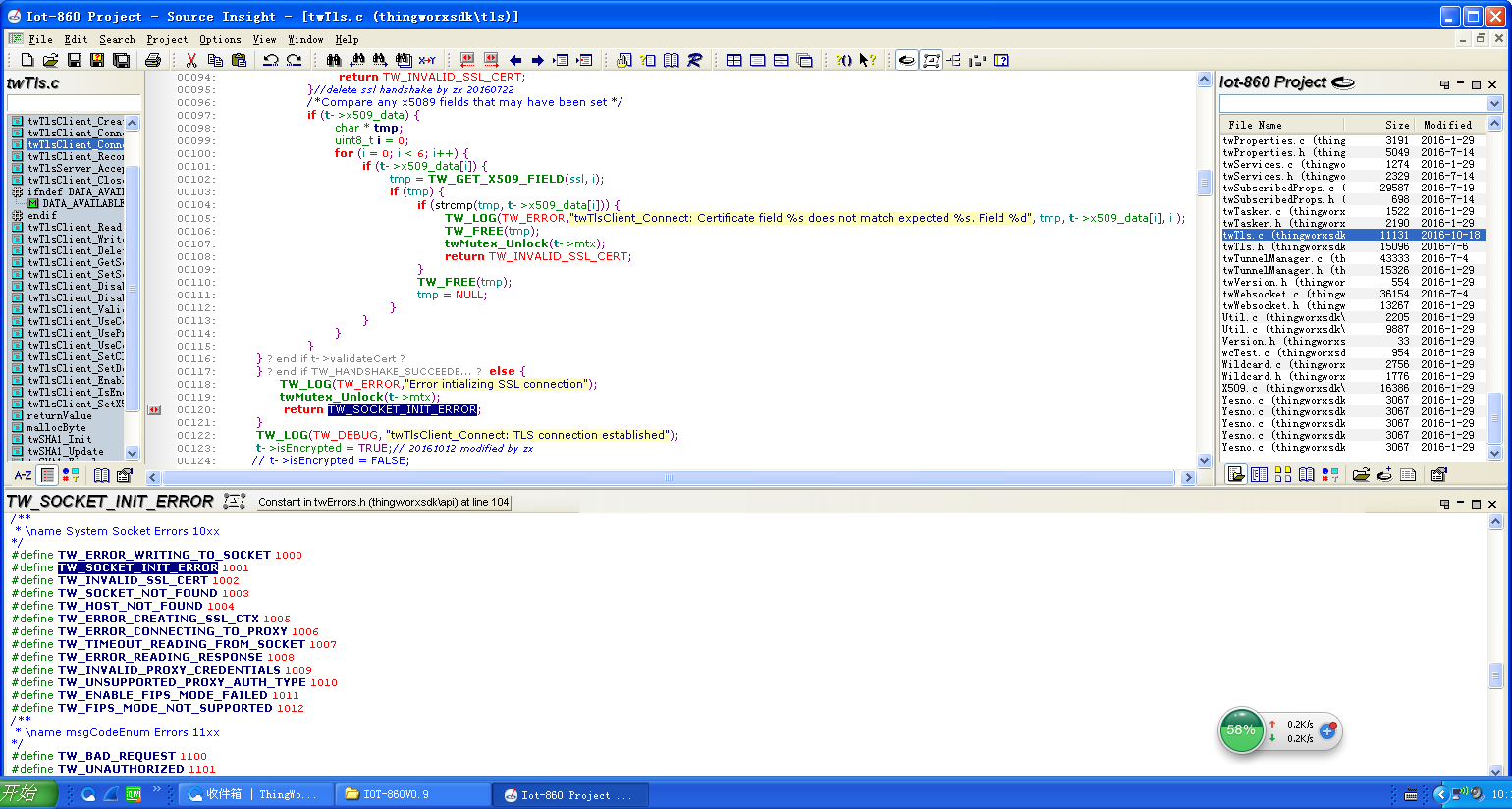

hi , I have a problem with C SDK. I use AxTLS , In the Server ,I use the certification.
in the main.c
int16_t port = 443;
twApi_SetSelfSignedOk();
twApi_DisableCertValidation();

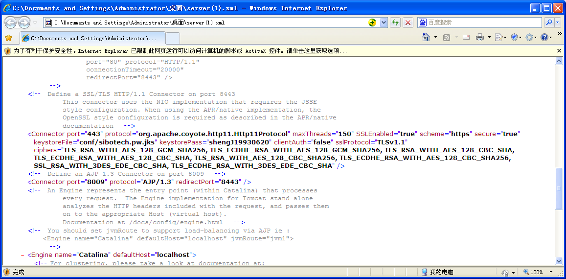

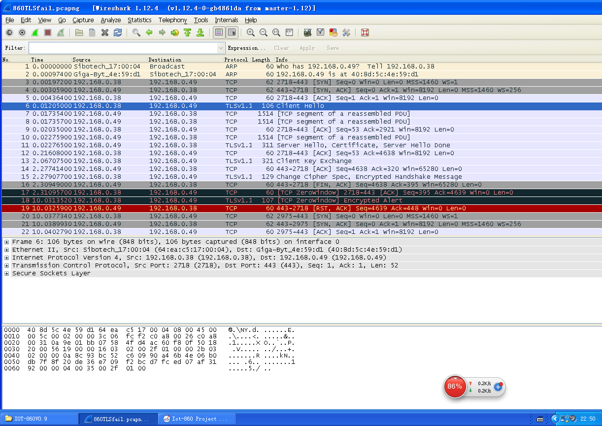

I use wireshark. I can see that the Server kills the connection. Can you give me some reason that why the server kill the connection? Thanks!
the server.xml
