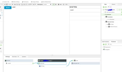

Set your service Output as InfoTable and set DataShape to it.
In Mashup, Call this service and map output to Grid Widget.
/VR

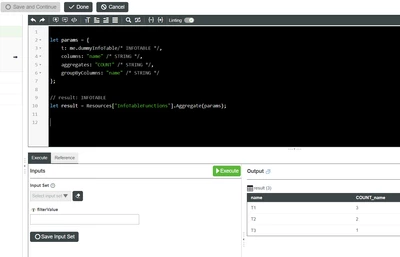

Hi @Aditya1702
You can use the Aggregate Function to get a count of values
let params = {
 t: me.dummyInfoTable/* INFOTABLE */,
 columns: "name" /* STRING */,
 aggregates: "COUNT" /* STRING */,
 groupByColumns: "name" /* STRING */
// result: INFOTABLE
let result = Resources["InfoTableFunctions"].Aggregate(params);

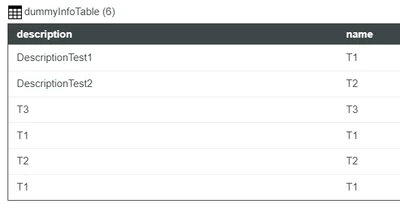

Input:
Output :
/VR
