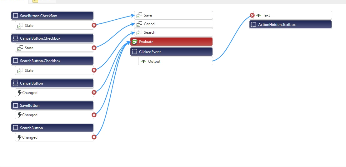

Hi All,
I have a service that will give the infotable output, This service will be called on 2 different button clicks like save and cancel,
Since we can bind single infotable to the grid in mashup it should be from a single service.
I want to know if there is any way to identify clicked event of a button on click
for example : if I click cancel, I should get an input as cancel and similarly on save
I had used Trigger service widget previously for such scenario, but unable to find that widget now.
If anyone knows about this widget could you please tell me where is it available to download ?
Thanks in Advance

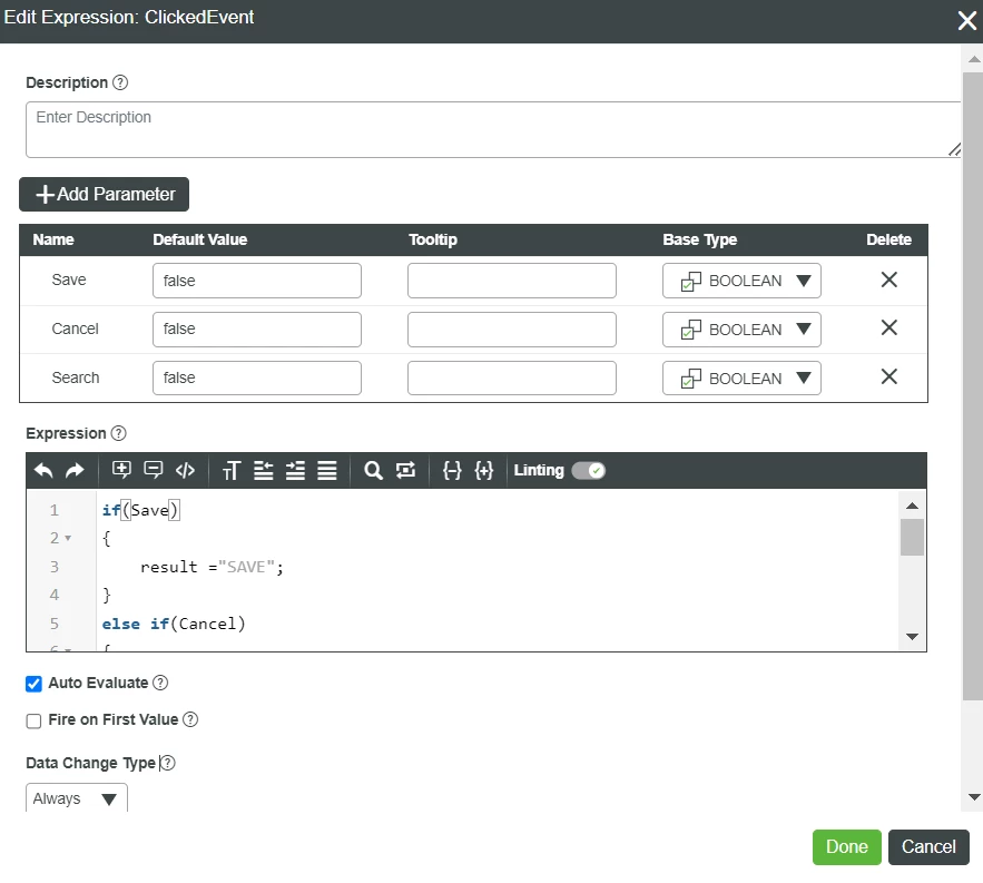

Jan 18, 2023 2:55 PM UTC
Hi Jens,
I am doing it a same way now, but the issue is it not evaluating the expressing always on click.
Not sure why
I am calling an expression for each buttons and setting one hidden checkbox to true and passing this value to one more expression and identifying the clicked event.
please see the images below for reference

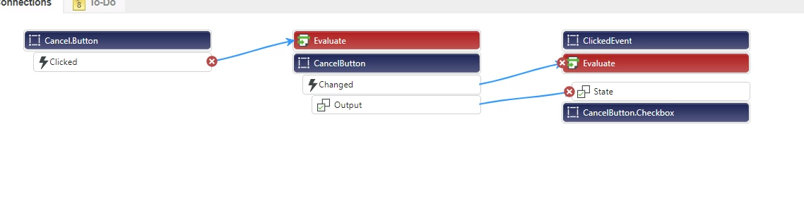

Jan 19, 2023 7:32 AM UTC
I think you are on the right track, and it would probably be possible to do it with checkboxes.
The difficult thing would be to reset the checkboxes after the button has been pressed, unless you use the "ServiceInvokeCompleted" event.
Here is a better eplanation of how I did it;
I have two buttons;
I will only explain one of them as it the second button use the exact same bindings;
The button click event gets fired and evaluates the expression.
The expression just outputs the name of the button:
That value then goes into an event router:
Which in turn (for testing purposes) goes into another expression.
The expression just logs the value that we input into it.
When pressing the buttons I get this log:
So as you can see, it gives me different values depending on what I press.
I am not sure if this is the best way to do this. So if anyone else has any ideas I'd be happy to hear them as well.
