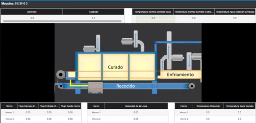

I made this mashup
I want to know if i can change a background color of a cell in the grid advanced depending of a cell value
Ex. In the first grid i have a value of "Diametro" it is diameter in spanish, if the value is between  100 to 200
the background color will be green, but if the value is under 100  the color will be red
Can i do this with a service or another tool?
Ty

Hi @Carlos97,
Cell-based state formatting indeed will not allow you to set limits dynamically. This should be achievable using a Configuration Service (Configuration property of Grid Advanced) as per Working with a Configuration Service by associating a stateDefinition to the column you want and use the service's input parameters to assign values.
Note that unlike what is stated here the example entities GridAdvancedExampleEntities.xml are not currently available on the PTC Software Download page. This has been reported so it can be added there. For now you will find the entities attached to this post.

Carlos971-VisitorAuthor
Jan 18, 2021 5:02 PM UTC
it´s almost what i was looking for, but i don´t want to hardcode the limits, i´ll took the value for a thing propertie

Hi @Carlos97,
