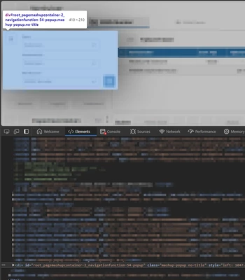

Can I change the modal pop up location by css
I want to check if the modal popup location, that is center of the screen can be changed by any means?
7-Bedrock
Mar 12, 2024 10:18 AM UTC
We do this using custom CSS on mashup level where navigation function is used.
Steps to reproduce:
  1. Define navigation function as ModalPopup
  2. View mashup and execute navigation
  3. Use devtools to inspect the html and find the id of the modal popup div
  4. Define the required position in the mashup custom CSS section (We also change the background blur opacity in this example):
.mashup-popup[id$='-2_navigationfunction-54-popup'] {
	left: 6px !important;
	top: 106px !important;
	position: absolute !important;
.mashup-popup[id$='-2_navigationfunction-54-popup'] .widget-bounding-box[id$='-2_navigationfunction-54-popup-bounding-box'] {
	width: auto !important;
	height: auto !important;
.mashup-popup-overlay {
	opacity: 0.25 !important;
Hope this helps.

Mar 12, 2024 1:59 PM UTC
Much appreciated, really nice example!
