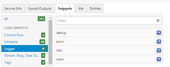

    Hi Jothi, you sure can add your logs using the code Snippets while creating your custom service in a Thing
    jk-31-VisitorAuthor
    April 7, 2017
    Hi Sushant,
    This code snippets helps to write the log in Application Log.My Scenario is i need a custom log file like xxxx.log.
    April 7, 2017
    You will have to implement by yourself, using just raw files and FileRepository Thing.
