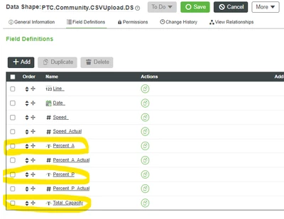

Hi @DR_10558933 ,
 I have tried to replicate the same case in my local Thingworx 9.4.0, its working fine. Can you please post your code/snippet which you have utilized in your service along with your Thingworx version.
Sample CSV File:
Sample Code to import CSV file to Thingworx  using ReadCSVFile Snippet:
Datashape fields:
Expected Output as Infotable:
Final Mashup Update in Grid:

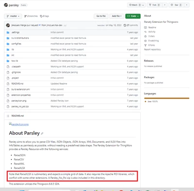

Hi @DR_10558933 ,
As per the Parsley Extension - 2.2.8 they mentioned in the note that "ParseXLSX is rudimentary and expects a simple grid of data. It also requires the Apache POI libraries, which conflict with some other extensions". I think the complete XLSX parsing may not be work in this case.
ParseJSON & PasreCSV are working fine in Parsley Extension. If it is single sheet data better go with CSVParseFunctions by importing & parsing the CSV files which is recommended by PTC Team.
As per this post you can also check with this person for the parsley extension related queries @jamesm1 /jmccuen@ptc.com.
