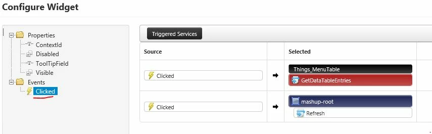

Need to select Clicked Event first
May 14, 2018
Hi, you can use the button to trigger the specific event:
In Button widget - Configure Bindings - Triggered Services page
You can bind the button to trigger any service or refresh the mashup

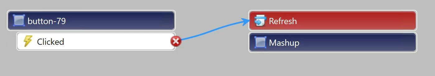

I already have the event associated with the mashup service "refresh", but when I click on the button, nothing happens, any ideas?
