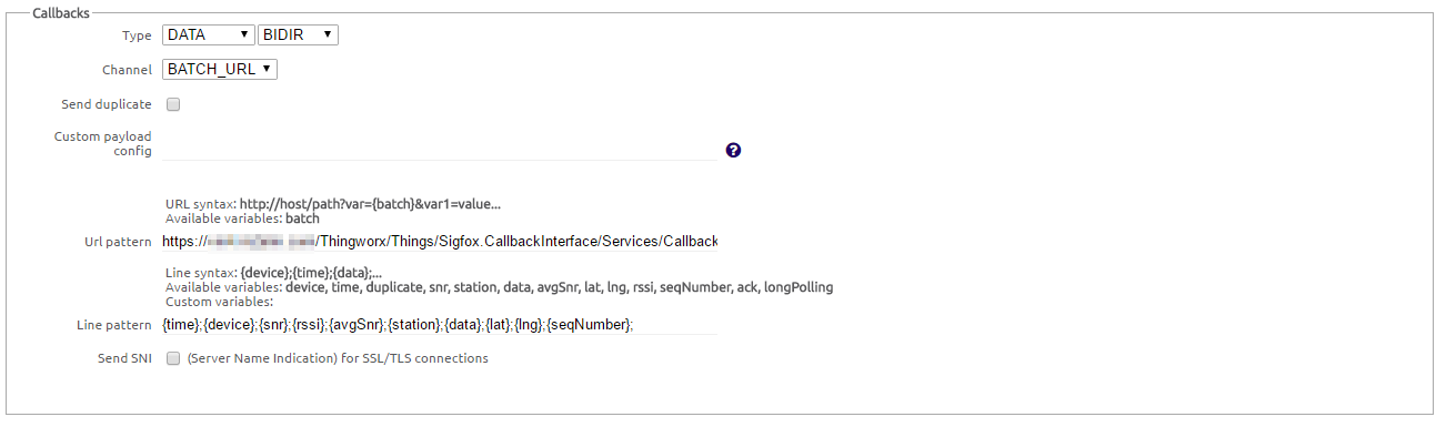

Hello
it works for me with following configuration in Sigfox (I think one item name  is wrong in  extension documentation avgSnr)
Have you selected "BATCH_URL" in Channel ?
