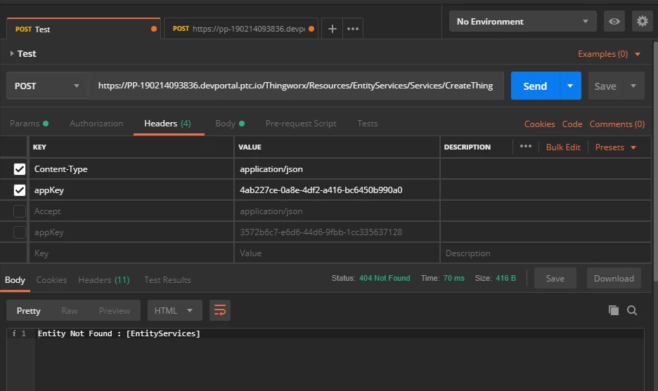

Hi!
I'm a beginner and I'm starting on Thingworx. I need to create a Thing in the tutorial (one of the first step) but I don't know why it doesn't work.
I put the appKey correctly. Same for the Content-Type JSON and the URL of my server with the rest given in the tuto.
I'm doing this on POSTMAN.
Can I have some help please?
Thank you in advance!
Best answer by Rick-Stanley
The user associated with the appKey you are using does not have visibility permission for the Resources/EntityServices endpoint
