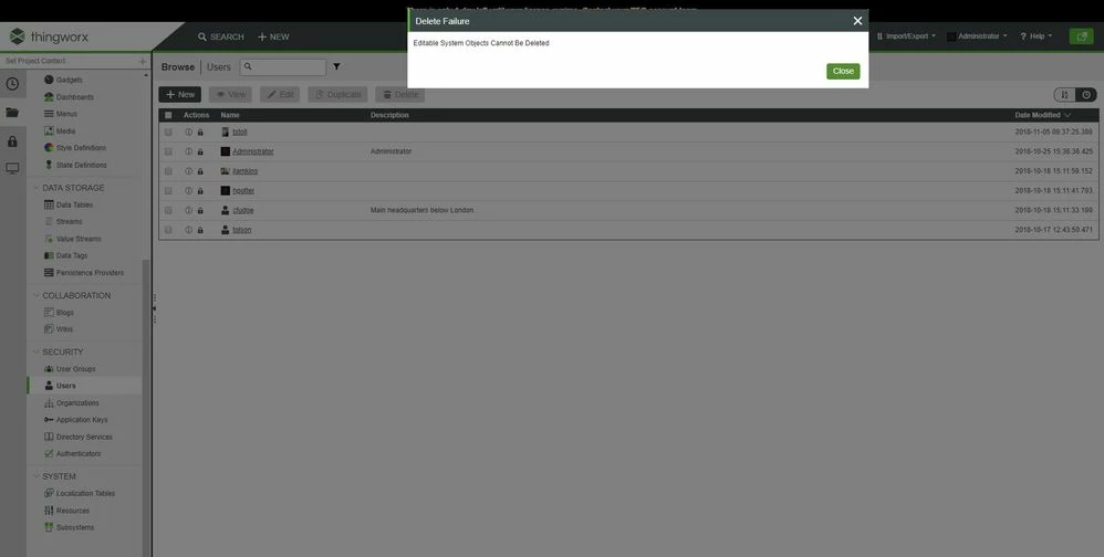

I was testing a service I wrote to allow users to create users using the CloneUserWithGroups() API.  When testing, I created a couple users while logged in as the Administrator.  That part worked fine.  My issue is: ThingWorx won't allow me to delete those users!!??
ThingWorx returned a Delete Failure error message saying, "Editable System Objects Cannot Be Deleted."
I've removed those users from the groups the Administrator is in, but I'm still getting the same error message.

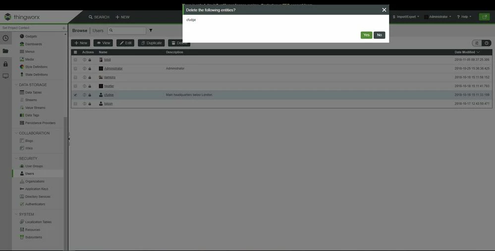

Can you provide a screenshot of what you're attempting to delete?  Based on the error message you're getting, it sounds as if you are deleting system objects instead of the users you created.

Can you switch to old composer and see if you get the same behavior?
