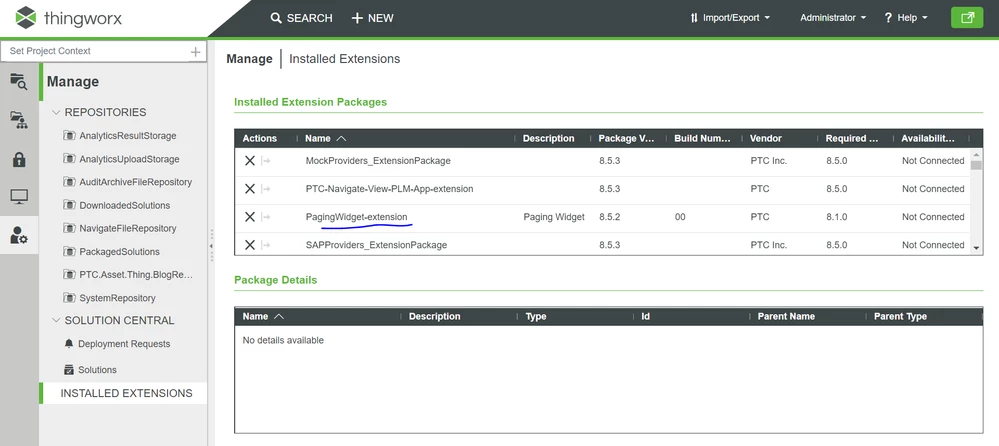

Can't find Paging Extension after I installed it
I imported the "paging widget" from the Thingworx Apps Extension bundle and it's showing up under the Manage>Installed Extensions in Composer but I can't find it in the widget list in the mashup designer.
Any help would be appreciated.
sdeyAnswer
Apr 3, 2020 1:51 PM UTC
Hey
I solved it. I went ahead and uninstalled the extension and restarted the server,then installed and restarted the tomcat and it got fixed.
I restarted the entire system once before but it didn't seemed to work.
Anyways Thanks

Apr 3, 2020 12:56 PM UTC
Hello and welcome,
Please find this article for steps on using the Paging Widget.
Let me know if you find this useful.
sdey1-VisitorAuthor
Apr 3, 2020 1:01 PM UTC
I have read this but the problem I am facing that the widget isn't available at all for me to add it to the mashup even though I have imported it. Is there any other extension dependency for paging widget?
Apr 3, 2020 1:00 PM UTC
Hi @sdey
Also when in the widget panel, make sure to select category All, it might not show under Standard.
If you still don't find it, please provide your version of ThingWorx and a screenshot of your installed extensions.
Regards
Christophe
sdey1-VisitorAuthor
Apr 3, 2020 1:06 PM UTC
Yeah I already checked under "All" but still missing.
My installed extension page, the paging extension is marked:Installed Pack.PNG
Apr 3, 2020 1:11 PM UTC
@sdey
Could you please confirm the version of ThingWorx you are using, go in Composer > Help > About for this.
Also could you please give the exact location where you pick up this extension. That will help if we need to test things .
Also could you attached your ApplicationLog.log file from when you imported the extension.
Christophe
