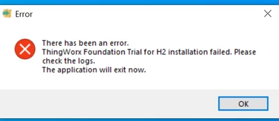

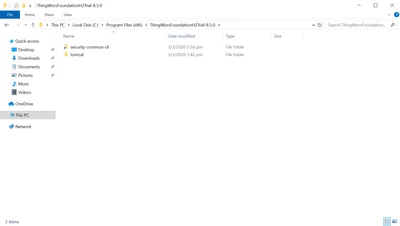

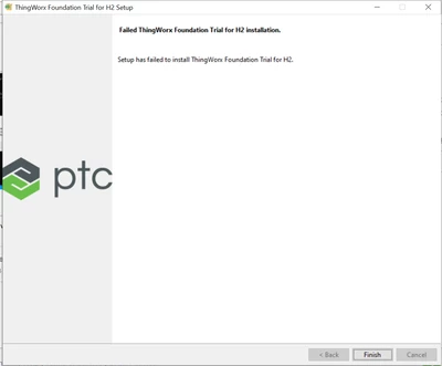

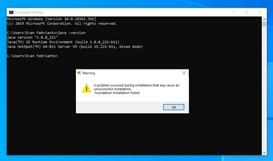

Hi, I couldn't install ThingWorx 8.5.0 trial version on my windows. I have followed the installation guide but it doesn't help. My java is 1.8.0 and 64 bit. Did I miss something during the installation? I couldn't even find the uninstaller or installation log.

I think you should have more than one bitrock*log files.
All of them are important to look at.
However I made a quick test and was able to reproduce the exact same error (now it may have several root cause).
I would recommend to do the following:
- Ensure that JAVA_HOME variable is set as System variable (not user variable) and points to a JDK not a JRE.
- Ensure that JDK/bin is in PATH system variable
- Execute sc delete ThingWorx-Foundation in an elevated  command prompt
Once this is ok, try again the installer.
Hope this helps
Regards
Christophe

Mar 4, 2020 1:23 AM UTC
Hi @slangley ,
Yes, that is the guide I am following. I did validate the system requirements as well as cleaned the registry and reinstalled the ThingWorx. But it still doesn't work. I was using ThingWorx 8.4 in another VM then I clone the VM and use ThingWorx 8.5.
