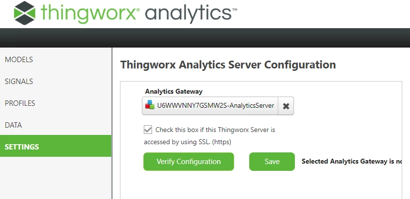

In the ThingWorx Analytics Builder,any page just always refresh and there's nothing I can do.
But there's no problem yesterday.
Please help

@CCi_9
Thank you for posting this on community.
Could you please check in settings tab if Analytics sever is up and connected?

hi,mgoel
it is the setting tabs you are talking about is this?
and i am confused about that the Analytics Server doesn't exist in the task manger. is it normal for that?

Hi @CCi_9 You can see the message, Analytics gateway not connected.
Do try this article: https://www.ptc.com/en/support/article?n=CS280862&posno=1&q=Analytics%20gateway%20not%20connected&source=search
Hope this will work. Do let me know in case of any question.

Hello @CCi_9
Can you conform "TW_ML_Session_Variables" ThingShape is attached to "UserManagementSubsystem" ?
If yes, try to run "setConfiguration" Service from "TW_ML_Configuration" thing.

Hi,Velkumar R
i tried but it still can't solve the problem
