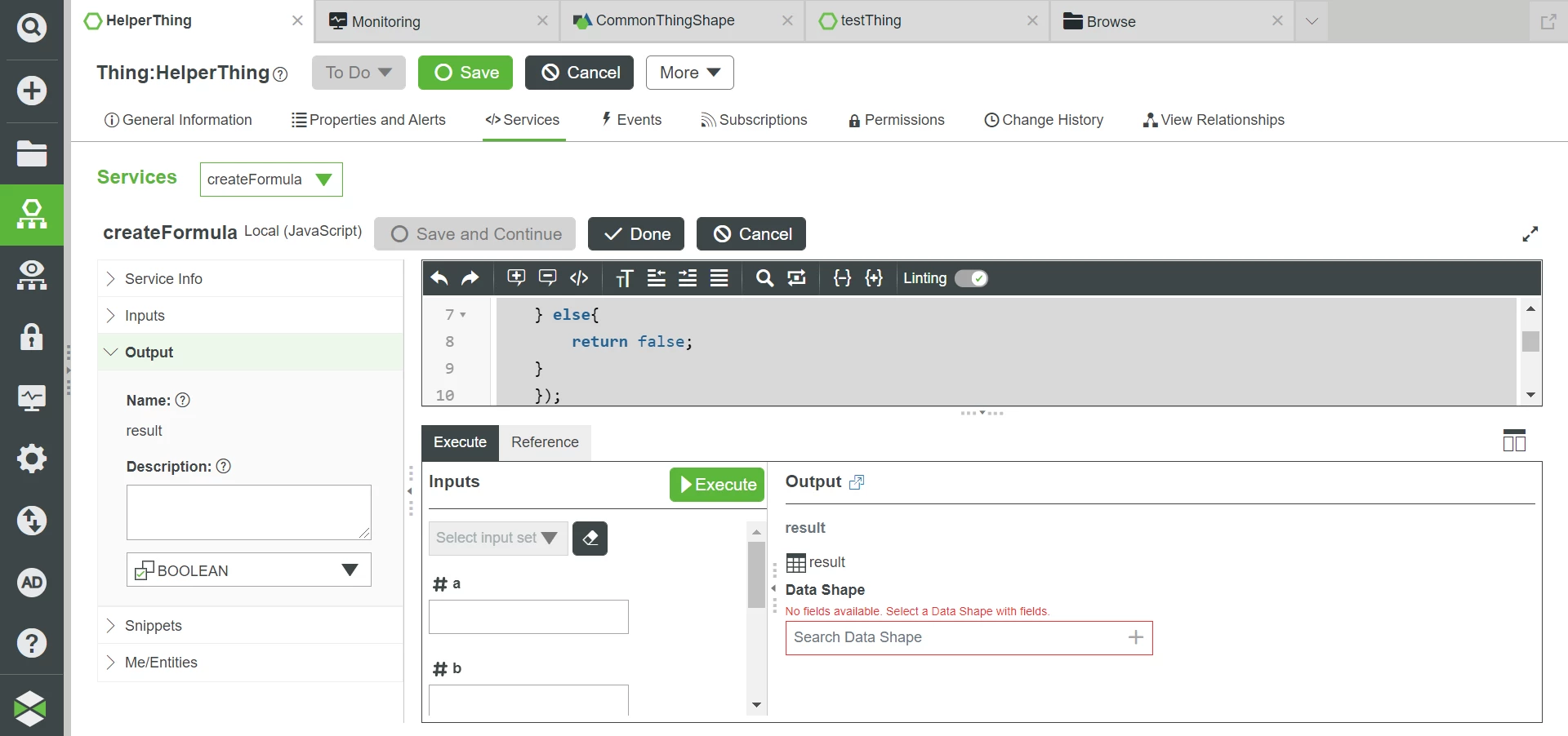

Can't understand why service is asking for datashape for output?
Hi I'm trying to make one service where I was using following code
service output should be boolean but when service is run it ask for datashape to show output. Please help me to understand this if I'm missing something
SERVICE CODE
SERVICE INPUTS
a --> number
b --> number
c--> number
formula --> string
try{
var formu = formula;
var formulaArray = formu.split("");
var check = formulaArray.forEach(function(value){
if(value === "a"||"b"||"c"||"+"||"-"||"/"||"*"||")"||"("){
return true;
} else{
return false;
logger.debug("formulaMaker "+ check);
// function evil(fn) {
// return new Function('return ' + fn)();
//var calculation = evil(formula);
result = check;
catch(err){
logger.error(err);
PaiChungAnswer
22-Sapphire I
It might be resolving into an error and you aren't giving a result in the catch.
PaiChung22-Sapphire IAnswer
22-Sapphire I
