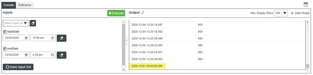

I tested your code in a service with one of my own properties and was able to get the expected result : an infotable displaying my property history followed by an additional row looking like this :

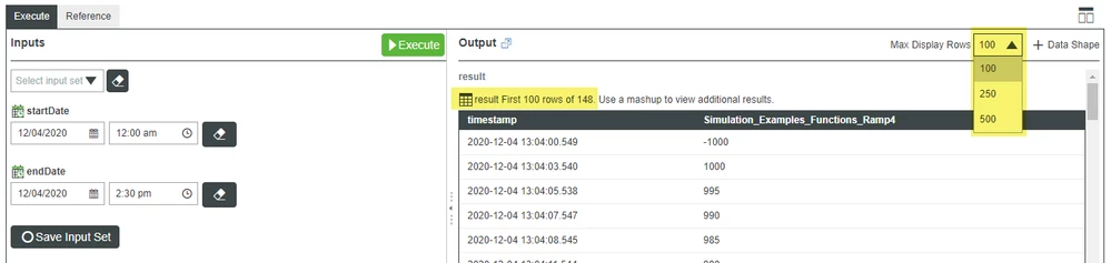

Make sure to show enough rows by selecting an appropriate value from the "Max Display Rows" dropdown list :
