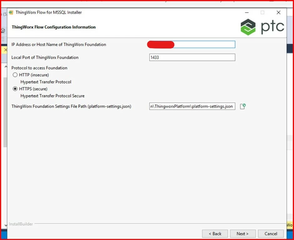

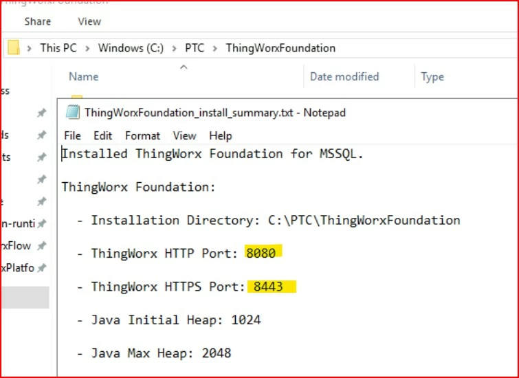

Nov 4, 2023 1:50 PM UTC
Hi @slangley ,
Thank you for sharing ThingWorx Flow details. While installing ThingWorx Flow I have made 1 mistake and added wrong port details.
ThingWorx Foundation Port: 8080  and 8443
I configured: 1433 (by mistake)
Is there any way I can update this port address now. Attaching SS of Port details which I used while installing.
Sid
Support
Nov 13, 2023 9:54 PM UTC
Hi @Siddharth_Jhs.
It is possible to change the port.  Refer to this article to do so, or uninstall and reinstall Flow, which is sometimes easier.
