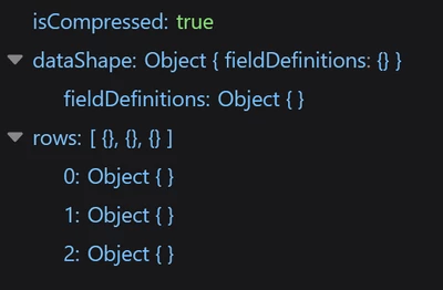

I have an infotable session variable called  testsessvar,  it is defined with a datashape (containing 2 text fields:  Doc_Name,  Doc_URL)
on the server side I have a service defined as follows
input  newinfotable_entry     (using same dateshape as the one the session variable uses)
tmp = Resources["CurrentSessionInfo"].GetGlobalSessionValues().getRow(0).testsessvar;
tmp.AddRow(newinfotable_entry);
result = tmp;
the output of this service is connected with the session variable in the mashup (so the update of the session variable is being done on the client side,  I have also tried to update it in the script with same result)
The idea is to be able to continually add rows to the infotable session variable

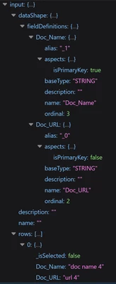

unfortunately the only thing being added is empty objects (the below image shows what gets returned from
the above service)
This second image shows the input value of newinfotable_entry
Best answer by TravisPickett
Hi @KK_9150368,
I have attached some example entities that shows adding rows to a session variable.  I am not exactly sure why your example is not working but in mine I passed in the info table session variable to my service to add rows.
If you are updating session variables via the session tab in a mashup ( client side ) it is best to pass this variable into your target service instead of using: "Resources["CurrentSessionInfo"].GetGlobalSessionValues().getRow(0).testsessvar".  The resources gets session variables server side.
Travis
