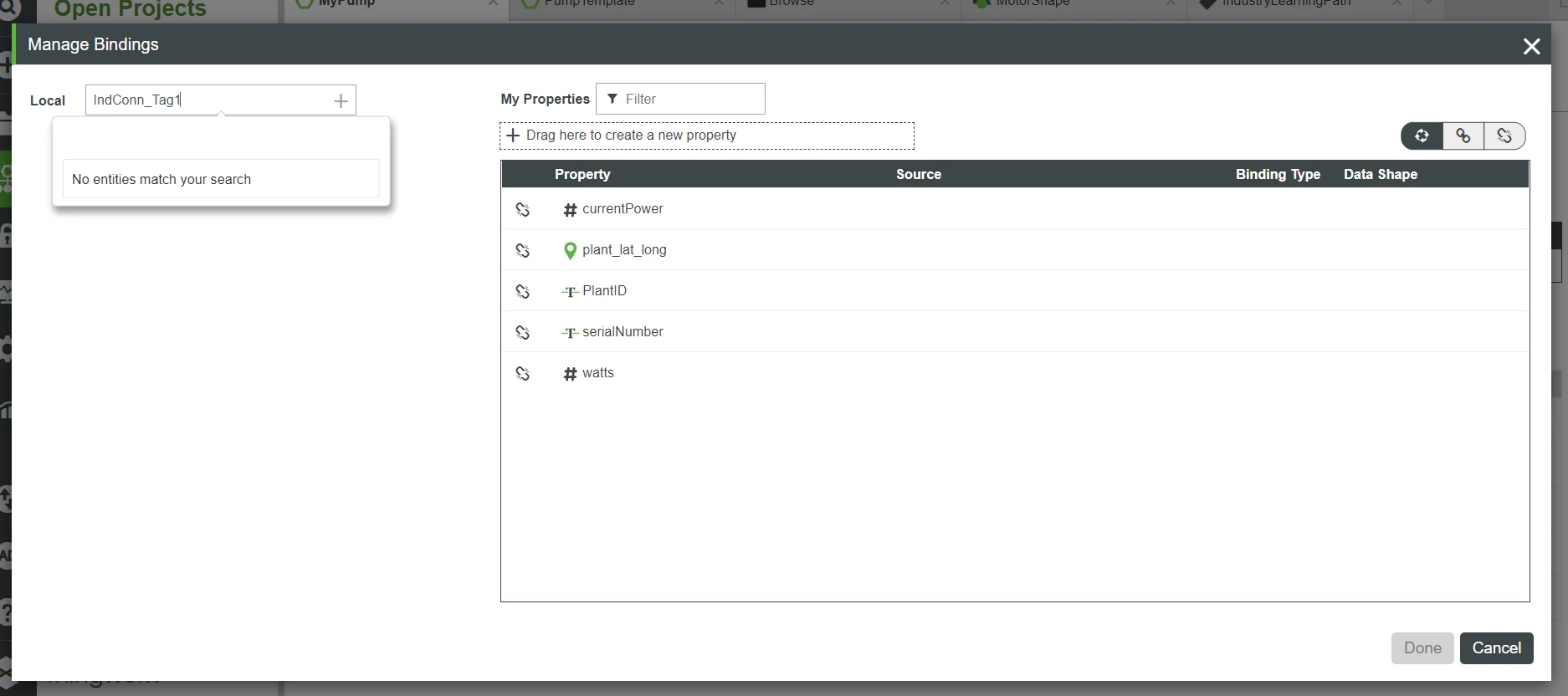

Cannot find IndConn_Tag1 in manage bindings in the topic - Building an equipment dashboard for pump
I am not able to go forward in the steps here. Cannot find this - IndConn_Tag1. This guide does say that I need a kepware server. Can someone guide me on both of these topics?
That guide can be used as part of this Learning Path:
https://developer.thingworx.com/resources/learning-paths/connect-and-monitor-plant-equipment
The first guide in that Learning Path explains who to install Kepware:
https://developer.thingworx.com/en/resources/guides/install-kepware-server-industry
