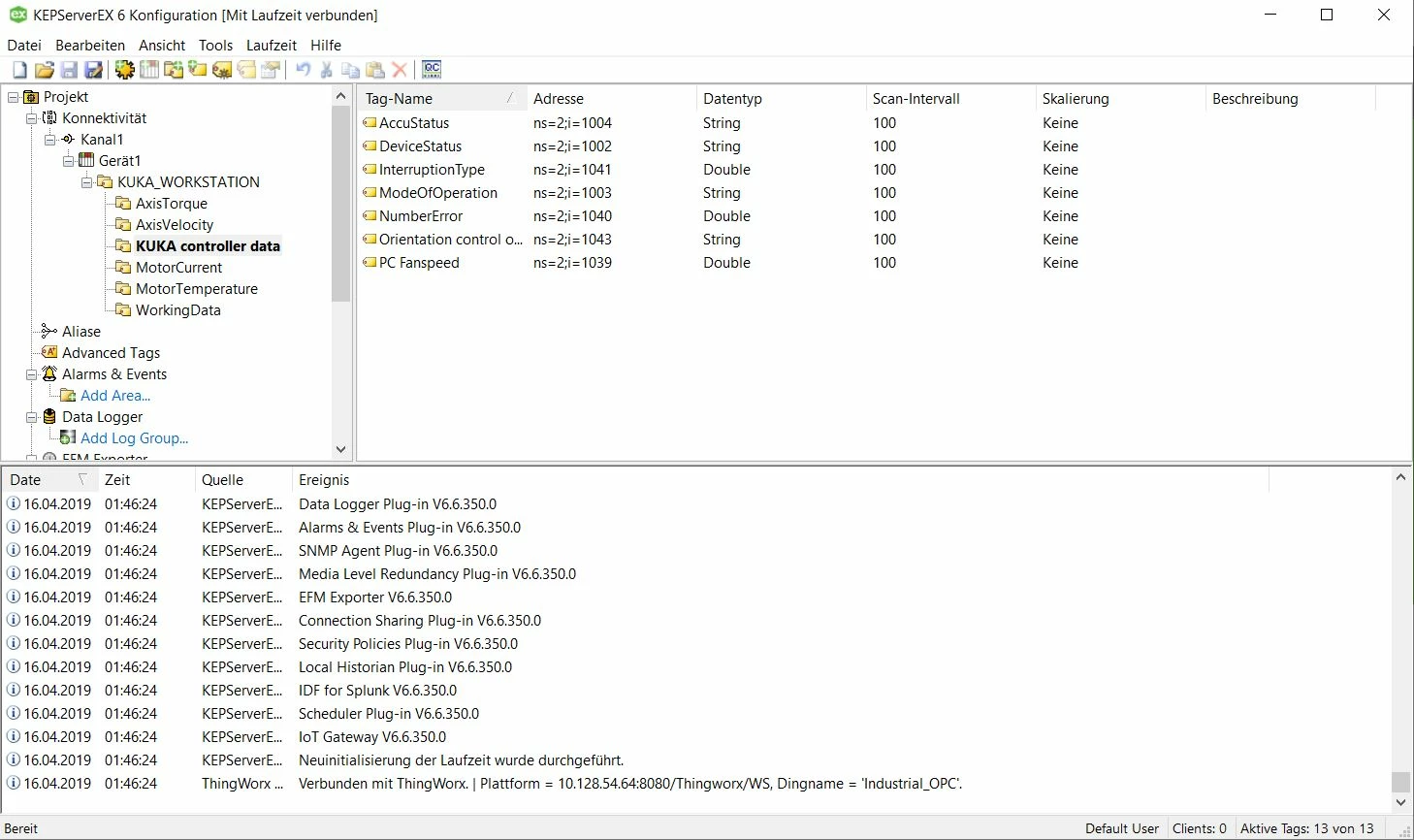

augmentor1-VisitorAuthor
April 15, 2019
Hi AnnaAn,
Thanks for the reply!
I`ve now used KEPServerEX 6 Configuration, to connect with my Server and the Thingworx Server. I`m now able to see the parameters in the KEPServerEX application. (Picture) How can i now bind them to the properties in Thingworx?
Is this the right approach? If I understand correctly, the KEPServer 6 on my PC is collecting the data from my other OPC UA server and then streams it to Thingworx.. Would this also be possible directly and not via my PC?
Thanks!
April 16, 2019
@augmentor ,
Regarding your question "Is this the right approach? If I understand correctly, the KEPServer 6 on my PC is collecting the data from my other OPC UA server and then streams it to Thingworx.. Would this also be possible directly and not via my PC?"
Yes that's correct approach to get OPC UA server data. If you install Kepware on another machine(say, same server to the OPC UA server, but it's not commanded) you will not need your PC to send data via your PC. The idea is that we use the kepware as a gateway to read data from OPC UA server and then as a OPC Server it sends data to the clients(say, ThingWorx)
That's a good start you have connected to OPC UA server via Kepware. Next step you would follow
this KCS Article  to know how to push Tag value to ThingWorx platform.
