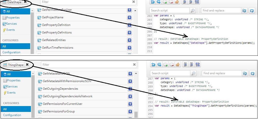

Also I noticed an error in Snippents for Entities filtered to ThingShape.
GetPropertyDefinitions snippet seems to be the same for both types pointing to DataShapes object holding both ThingShape and DataShape. Correct me please if I don't understand this properly.
