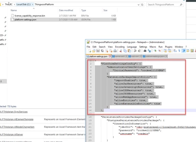

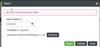

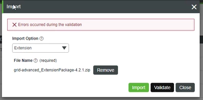

I'm trying to import extensions into Thingworx8.4.1 but found below errors:

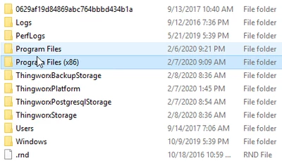

I followed the PTC install guide to manually create thingworxplatform folders and the platform-settings.json:

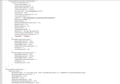

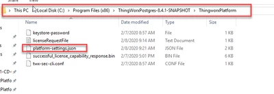

After I installed the 8.4.1, I found another 3 folders were created and another platform-settings.json file here:
Once I trying to add the "extension policy" parameters to the second json file, I cannot connect to thingworx. In fact, once I modified anything in the second file, I cannot connect.

how am I be able to import the extensions?

Best answer by rosharma
i think things might have gone mismatched or mixed up between the types of installations
one of types of installations is through installers and the other one is the normal one(through separate softwares setups)..
try to see and fix it in this direction
