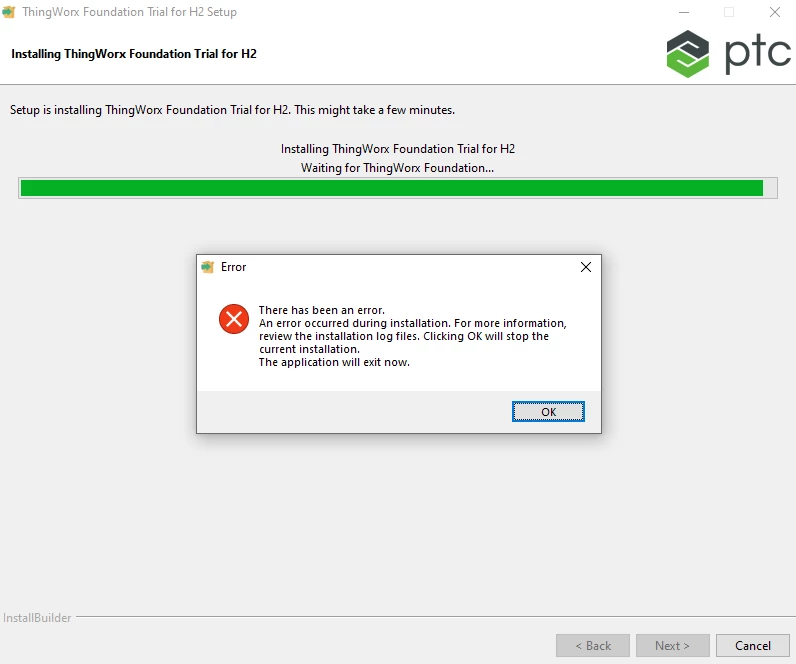

I just start working with thingworx and I can't install the foundation. It got this message and I got no idea where the install log file is. I want to know where log file is and solve this issue.
If any information needed to be provided, please.

@CS_9755001, check the logs at location.
  • <Install Location>\installer\logs\foundation-<date time>.log
  • <Install Location>\installer\foundation\local-mode-cache/cache/chef-stacktrace.out
  • <User Directory>\AppData\Local\Temp\bitrock_installer.log
Run the installer in debug mode check for error.
  1. Open Command Prompt as an Administrator
  2. Navigate to the directory with the installer executable
  3. Execute the following command
    • <installer-name>.exe --debuglevel 4
      • For example
        • ThingWorxFlowPostgres-8.5.4-x64 --debuglevel 4
  4. Proceed through the installer until the point of failure
  5. Collect all DEBUG log files prior to closing the installer
    • When the installer window is closed a cleanup activity will be performed which deletes most files and directories (including log files)
  6. Close the installer
This issue can be possible because of invalid java path or try runing with admin permission.

Hi @CS_9755001 ,
Do not click on the error ok which prompt up because it will rollback the installation and delete all log folder .
Send the srderr.log
"C:\Program Files (x86)\ThingWorxFoundationH2Trial\tomcat\current\logs\thingworx-foundation-stderr.2020-12-16.log
It is also possible some reference already exist so try installing after deleting all folder regarding to old install.
