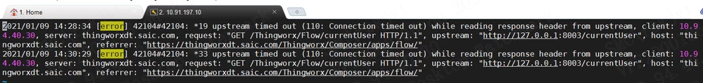

ThingFlow keep hanging when launching it , I've  checked the article https://www.ptc.com/en/support/article/CS323653
, but still doesn't help.   could be any other reason ?
ThingWorx 9.1.0
OS: REHL 8.2

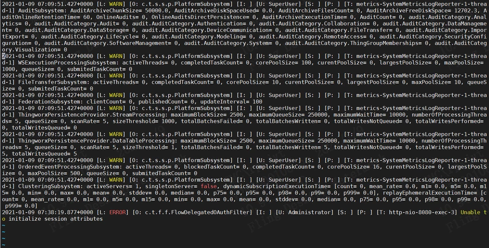

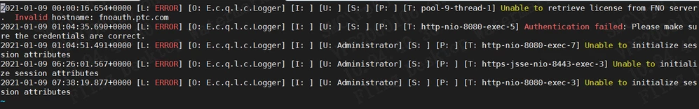

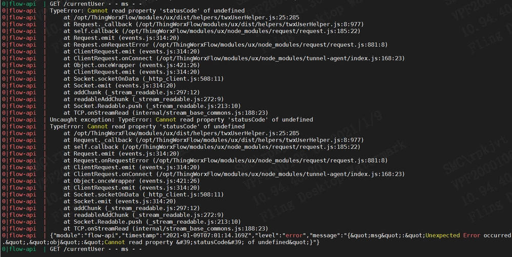

I found more logs may related to the request: currentuser:
