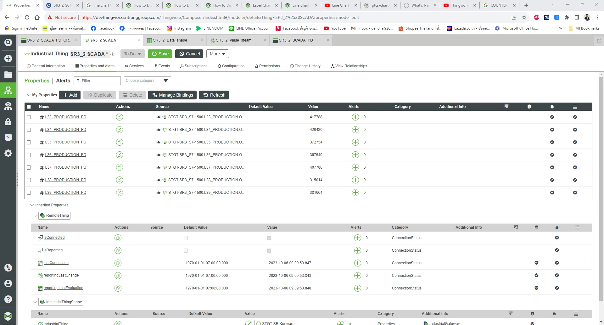

I get data from Kepware in DWORD and want to show in mashup but doesn't show. How to solve it?

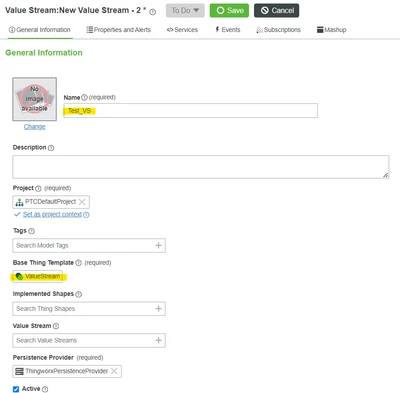

You have to few more steps to show data in line chart,
  • Log the Thing property values
    • Options: ValueStream, Stream, External Table
    • Easiest way to log the property values is Value Stream method
  • Use "QueryPropertyHistory()" service to pull all logged values.

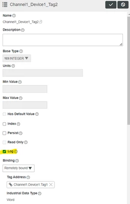

To log into Value stream:
  1. Create value stream with "ValueStream" as Thing Template.
2. Attach the Value Stream into the Thing where the properties needs to be logged.
3. Make property to be "Log"
4. Now, you can use QueryPropertyHistory()

DWORD from kepware will automatically consider as NUMBER basetype in thingworx so that you can able to view the values in Remote Thing level.

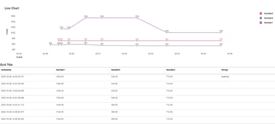

I want to be like this X-Axis is Time and Y-axis is data number. if possible i want to show about 6 line in one graph. this i answer you correctly? Thank you

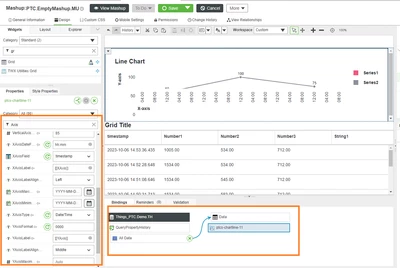

Hi @DR_10558933 ,
I did replica of your case in my local TWX 9.4.0. Can you please confirm you TWX version and check below image like the same you are preparing?
UI Design:
Output:
Thanks & Regards,
Arun C

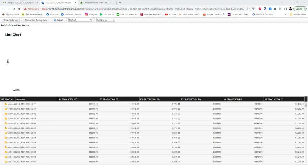

8-Gravel
Oct 6, 2023 6:56 AM UTC

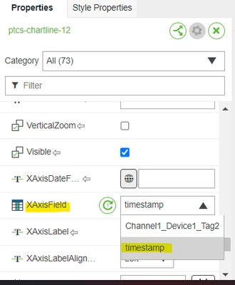

I follow you step in form of grid is work but in form of graph doesn't show anything. Have anything i make mistake?
Oct 6, 2023 11:08 AM UTC
select timestamp field in XAxisField
