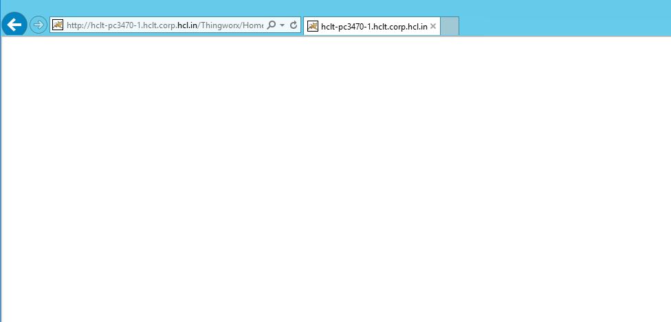

Once installed and start the thingworx from Internet Explorer, it does not ask for any Log in, there is a blank page shown without any errors. Below is the screenshot.

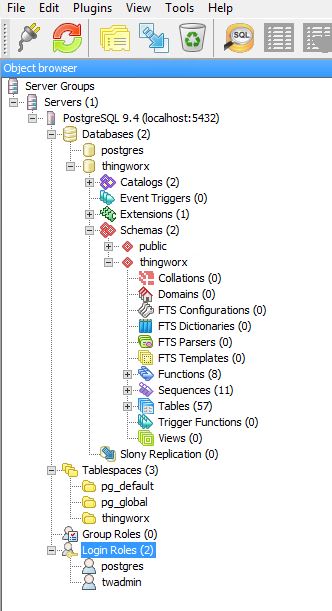

Below is the screenshot of the PostgreSQL,
All the thingworxstorage, thingworzbackstorage, thingworxplatform are all places directly under E:/ and it is shared with the all the users.
Any help is greatly appreciated.
Regards
Naveen

Jun 19, 2017 6:02 AM UTC
yes I can connect to ThingWorx database running on PgAdmin tool.
Jun 19, 2017 3:10 PM UTC
Huang ZhaoDong
Can you check that the username and password you use to connect to postgres through pgAdmin are the same as in the paltform-setting.json, that is username twadmin, password: password ... if not please update the platform-settings.json
Kind regards
Christophe
Jun 20, 2017 12:51 AM UTC
I check username and password is OK , but tomcat error JDBC connection.

Jan 30, 2018 5:02 PM UTC
I had this same problem.  Everything was setup correctly and the platform-settings.json file was perfect but I still got the message:  password authentication failed for user "twadmin".  The problem is it is not seeing the platform-settings.json file.  I set the THINGWORX_PLATFORM_SETTINGS environment variable to the correct folder, restarted Tomcat, and all worked correctly.   Errors were gone and I got the logon prompt.
I add this tidbit because no one else had mentioned it yet.
Good luck.  Robert.
