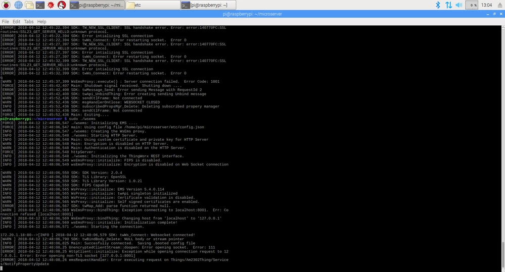

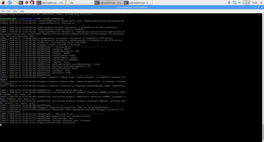

I am trying  to connect a Raspberry Pi 3 to Thingworx using the EMS 5.4.
I am able to autobind in the config.json file but if im trying to bind it via LSR its not connecting.
Also the Properties dont get connected.

config.lua
scripts.log_level = "DEBUG"
scripts.Am2302Thing = {
	file = "thing.lua",
	template = "Am2302Template",
	identifier = "2302",
	scanRate = 10000,
	TaskRate = 300000
scripts.rap_host = "localhost"
scripts.rap_port = 8085
scripts.rap_ssl = false
scripts.rap_server_authenticate = false
scripts.script_resource_host = "localhost"
scripts.script_resource_port = 8086
scripts.script_resource_ssl = false
scripts.script_resource_authenticate = false

Best answer by CRArko
Hello.
This is a known issue with EMS 5.4 and a bug has been reported.
The suggested workarounds for the time being are to either enable SSL in EMS 5.4 using TLS encryption or to downgrade to EMS 5.3.4.
-- Craig A.
CRArko5-Regular MemberAnswer
April 20, 2018
Hello.
-- Craig A.
