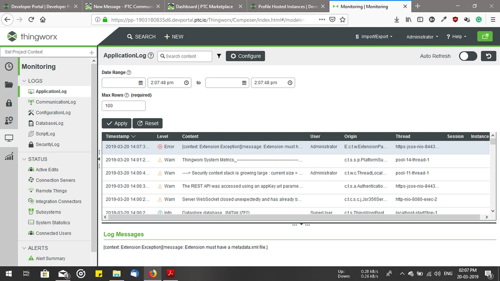

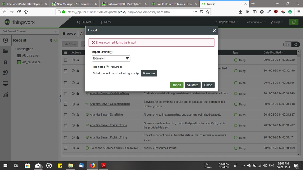

I tried to install Data Export Extension plugin in thingworx 8.4, got from marketplace but cant installed it. it gives error. screenshots as follow.

Are you pointing it to the actual zip file.
since it is saying it can't find the metadata file you can check the zip file make sure metadata.xml is in it.

March 22, 2019
yes I have pointed it to zip file.
