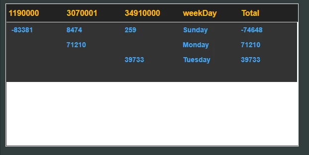

Hi. I am trying to get the Grid Area  of the Advanced Grid configuration transparent. Does anyone know how to do it?
Here's the config I am using:

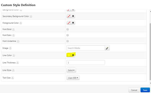

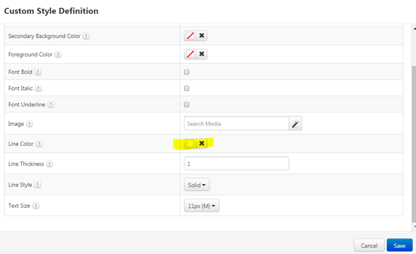

Greetings @emoreira,
You can configure Advanced Grid properties as mentioned below to achieve the required.
1) Customize the 'RowFormat' property of Grid Advanced Widget
Make a new custom Style Definition for this property and Set Line Color to white as highlighted in below screenshot.
3) Customize the 'RowAlternateBackgroundStyle' property

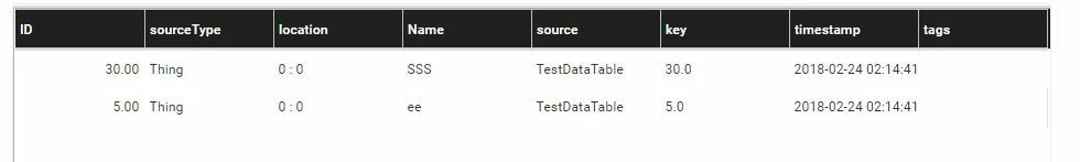

4) Save and refresh the mashup. The grid on mashup will be like as follows :
You can also configure "TableHeaderStyle" property to remove the background color from Header Line.
Hope it helps to fulfill your requirement.
