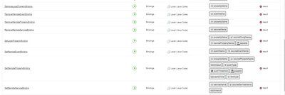

Change binding through script
Can I change a binding like in manage bindings menu through script? and if I can, how so ?
Arun_CAnswer
Jul 8, 2024 4:34 AM UTC
Hi @GV_11098078 ,
In thing level you can find the  'SetLocalPropertyBinding,SetRemotePropertyBinding,RemoveLocalPropertyBinding,RemoveRemotePropertyBinding'  with the help of these Binding Servcies  you can easily manage the bindings to property in script level.
