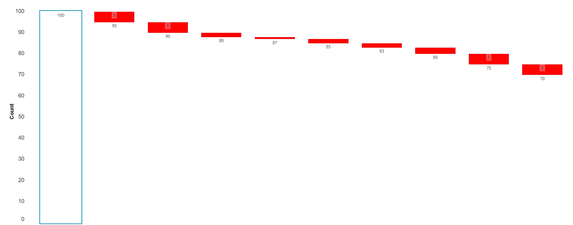

I'm trying to develop a waterfall chart from a bar/column chart but for this to be finished I need to change the background colour of the first bar.
I set the series with the NumericEntry values as white and the difference between the entries (consecutive rows) red to make them "float" in the chart to simulate the waterfall effect.
I tried to change the background colour of the first column in the custom CSS tab but I cant override de white colour of the series.
Can someone help me achieve this?
Thank you very much
PaiChungAnswer
22-Sapphire I
June 28, 2021
I believe there is a new widget in ThingWorx 9.2 that does what you want.
In your case perhaps you can use state based formatting and drive the state based formatting with a separately generated column of values.
