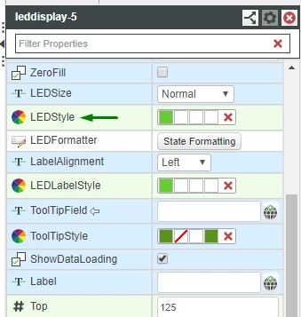

  • Create two led button widgets. Create your custom style definitions and assign them to these LED widgets through "LEDStyle" option

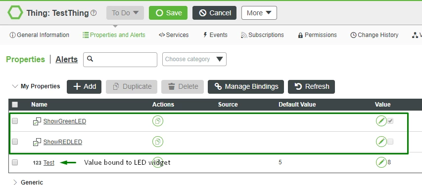

  • From the thing where you are binding the value to LED display widgets, add two more properties of type Boolean. These properties are used to determine which LED widget to be displayed.

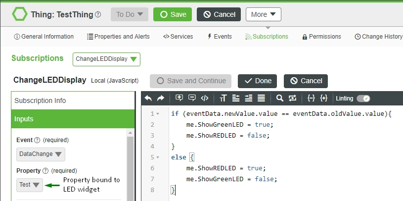

  • Now create a subscription on the thing based on the DataChange event of the binding property.

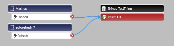

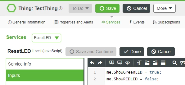

  • Write a service under the same thing to Reset the LED visibility.
  • Set the default value of ShowGreenLED to true, ShowREDLED to false.

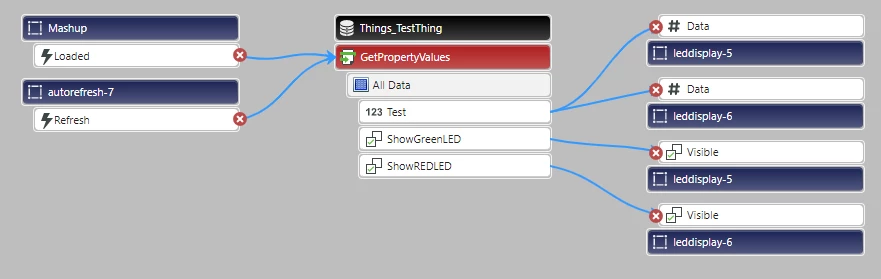

  • Now bind the data to the widgets. Please find attachments for your reference.
  • Set the auto refresh interval to 5 and you will have your desired functionality.
