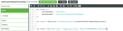

I currently try to upload an image to SAP via Odata as Attachment.
Everything is fine, but i have one issue.
The SAP Endpoint expect a Content-Type : (f.e) image/png...
But the service send everytime application/json.
I've allready changed the getCustomHeaderParameters... still not working. Any Idea how i can change the content type?

Hi @bot1q.
What version of ThingWorx are you running?  Beginning with ThingWorx 8.4, we introduced a tool called Flow that may better address your issue.  However, there have been improvements to Flow in the ThingWorx 8.5 release, as well as the upcoming 9.0 release.

Is that the Integration Runtime SAP Odata connector?
If you don't have access to Flow, please try the standard ContentLoader snippets.
When I need to add my own headers so that the call would work, I use those instead.
Let us know what you managed to do.
