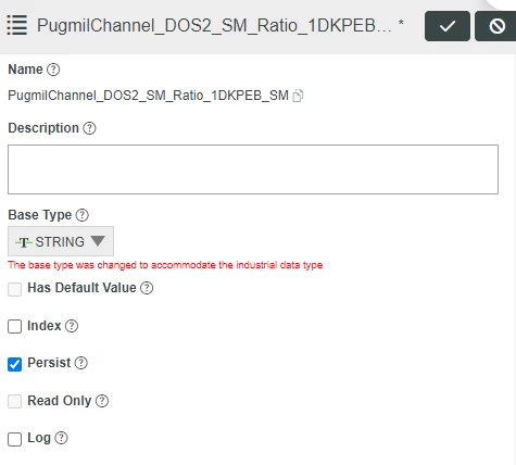

I want to read data from PLC using kepware, I use the industrial connection, and I want my data type to be a number but I can't change the data type. How to change this?

Sep 4, 2023 12:20 AM UTC
Sorry, i accidentally clicked accept as solution.
Yes i already checked it, i chose default, but when i opened the tag in Quick Client, it showed me that the tag data type is float.

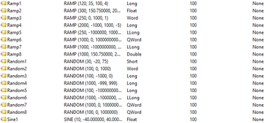

Sep 4, 2023 3:23 AM UTC
It should works. If Possible, Can you please share your snapshots of Kepware Tag details and Property bindings with Thingworx Thing for more clarification?
