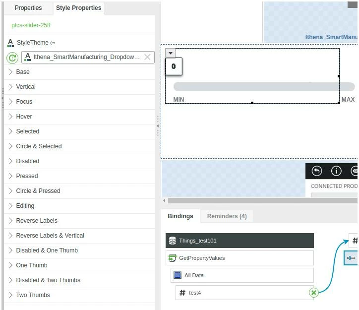

Hi All,
I am trying to change colour of the slider (progress bar) but i cannot find any documentation regarding it. I am using thingworx 9.1 can some one share thoughts as to where is the configuration option.

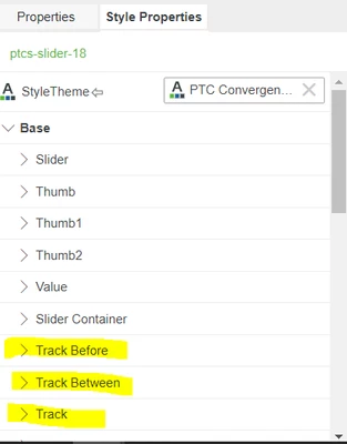

Hi @SachinSharma,
Thanks for the input, but the issue was solved by changing the style definition as it takes the slider progress colour from Style definition so we updated it and saw the change.

Mar 31, 2021 10:26 AM UTC
Could you suggest which one?
Please find the attachment
Thanks & Regards,
SO
Apr 1, 2021 5:07 AM UTC
@SO_9699370
Use the properties shown in below screenshot,
Sachin
