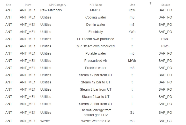

Your JSON is not correct.
"rows" and "styles" need to be on the same level as "columns", not a child of the node.

Hello PTC team,
I tried to follow the configuration of JSON to the data grid
I'm trying to update the background of Source column as shown below using the configuration under properties tab of data grid.
expecting if
Source column value is
SAP_PO then background of cell colour needs to be red
SAP_CC then  background of cell colour needs to be green
I have gone through the examples of configuration of json GetEmployeeRoleBasedConfiguration. But i failed to get the expected output.
I have enclosed the config file and image for your reference !
Looking forward for your support to solve this issue
Many Thanks !
