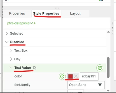

You can change it in widget style property
/VR
/VR

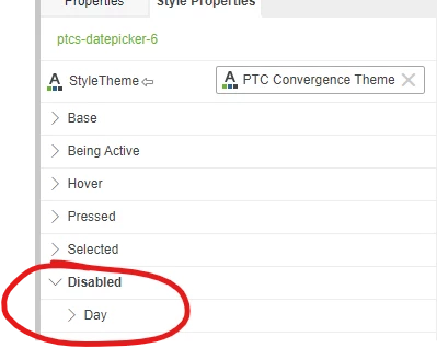

I do not have this in my version of TWX as stated in the original post. Version 9.0. I need another method. This will not work for me unfortunately.

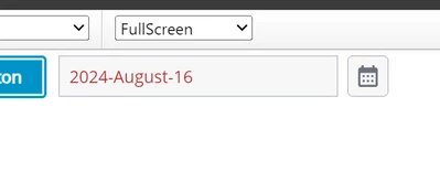

Can you please try below Custom CSS to see if it works?
ptcs-datepicker[disabled]::part(date-field)::part(text-value){
     color:red;
Note that if you upgrade your ThingWorx, this CustomCSS might not work, please switch to the Style Property way as @Velkumar mentioned once it's available in your new ThingWorx system. ThingWorx 9.0 is old not not supported anymore.
