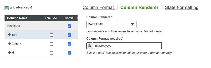

In the "configure grid columns" menu of the advanced grid, you can format each column individually.
You can choose DATETIME  and either choose a localisation token or use your own format :
