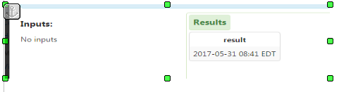

July 10, 2017
var dateValue = new Date();
// dateFormat(dateValue:DATETIME,dateFormat:STRING):STRING
var formattedDate = dateFormat(dateValue,'yyyy-MM-dd hh:mm zzz');
var result = formattedDate;
It's automatically coming in EDT
While I want it in CDT
