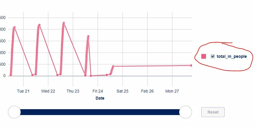

i have a chart in my application.
I want to change the legend text, the defalut text is the property name (file attached)
How can i achieve this goal please ?

Hello @AliBenBelgacem ,
As far as i Know, Legends would be coming from the Key Which represents the Y axis. I assume you can not change it.

according to the PTC instructions, the number of records must be fixed. Then you can adjust the labels according to the number.
Set the property "NumberOfSeries" for this.
After that, depending on your number, further options appear, like the DataLabelN.

Hi ,This  9.3 feature i think, i am using 9.1
