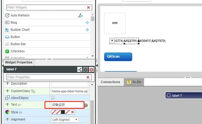

The content of the Text property of the Label component in Mashup is Chinese. After exporting to an Xml file (the encoding of the Xml file is utf-8), when viewing it with a text editor, you also see Chinese content. However, after importing the Xml file in another fresh installation of ThingWorx 8.4, the Text property of the Label in Mashup displays "设备监测", as shown below:
However, the Text property of this Label's Widget Properties page still displays Chinese.
When I position the cursor in the Text property input box and then move the cursor out of the input box (press the Tab key, or click the left mouse button anywhere), the label can display Chinese normally again.
How to solve this problem? Thanks.
