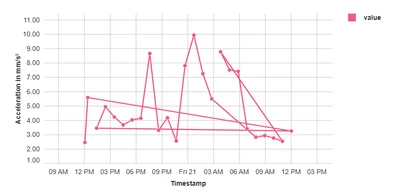

Chart widget is connecting wrong
  • May 21, 2021
  • 4 replies
  • 2169 views
like you can see in the picture below the chart widget is connection the dots wrong. It seems like it does not recognize the order by datetime/timestamp.
When i update the chart sometimes its correct and then its wrong again. I am creating the data through a selfwritten service. See below:

What the code should do is following:
Query data from a property valuestream. Divide the values, and the timestamp of the querydata in to chunks of 3600.Do calculations by selected statistictype (min,max,rms..) for each chunk. Take the last timestamp from chunk and apply it with the calculated statistic value to a infotable. In my property i have nearly one data point per second. Therefore when querying for 12hours i apply calculations on each hour and get 12 data pairs of calculated value and last timestamp of each chunk.
But unfornately it is not connecting the values correctly.
Does someone has a clue why this is happening? When i plot data from the property valuestream directly without calculations,i do not have this issue.
Best answer by nmilleson
Your GetDataTableEntries at the end may not guarantee any order either..  perhaps try a sort function on that result.
May 21, 2021
In your me.QueryNumberPropertyHistory service, try setting the OldestFirst option to true.  That should sort it from oldest to newest (like you'd expect to see on the time series chart).
May 21, 2021
Just tried it. Nothing changed
nmilleson17-PeridotAnswer
May 21, 2021
