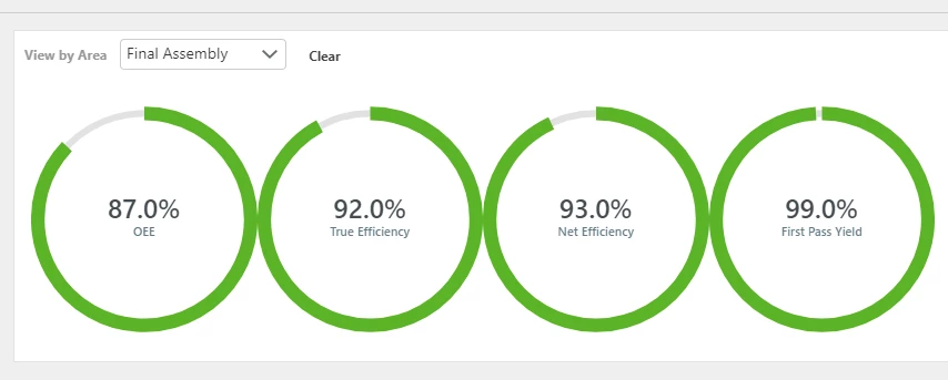

I am developing a realtime project. I have few requirements where I have to use charts that I have attached.
I have gone through the demo project where I want to get clarified whether these charts have been developed using thingworx or manufacturing app.
If It is developed using thingworx classic composer, how can I develop them. Please provide some document or idea on how to develop.
Please provide some solutions as early as possible.

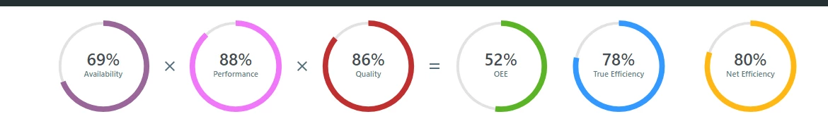

I am not sure what "demo project" you are referring to, but it seems to me that the gauge widget (in charts 1, 4, 5 and 7) is a ProgressGauge widget found on the marketplace (https://marketplace.thingworx.com/tools/progress-gauge) with additional, standard, label or valuedisplay widgets for the data labels.

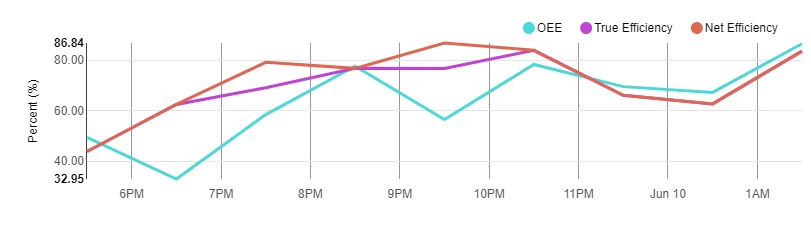

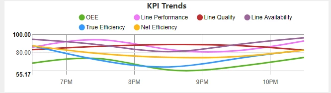

The time series charts (in charts 3 and 6) looks to be the TimeSeriesChart2 (possibly) found on the marketplace under chart widgets (https://marketplace.thingworx.com/tools/custom-chart-widge).
Chart2 seems to be a combination of the timeseries chart at the top and the progressgauge in the bottom. The progress bar at the top in chart2 image looks similar to a chart in a sample mashup used for Thingwatcher on the developer portal (https://developer.thingworx.com/resources/guides/anomaly-detection-how-guide/import-sample-mashup). It seems to be a normal timeserieschart with the data in a specific format and specific styles. You might be able to reverse engineer the functionality by looking at the way they have implemented it.
