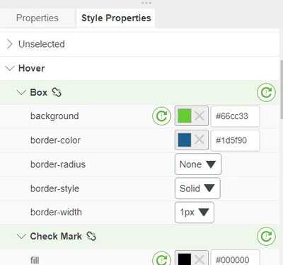

Checkbox color can be changed from style properties. Refer below screenshot, there are options to change the box background color when you hover, hover & selected , pressed & selected.

Hover color for checkmark can also be updated from style properties. Navigate to Style Properties> Hover> Check Mark> fill and update the color to match the background, now when you will hover over the box the checkmark wont be visible.
