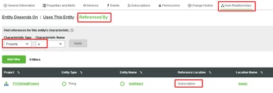

Have you enable the "Referenced By" in the RelationshipSubsystem? You should be able to use the View Relationships>Referenced By mashup then on the ThingEditor.
