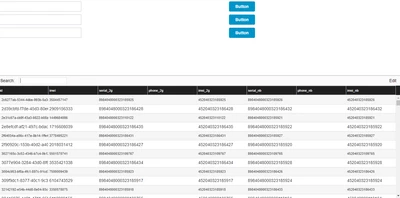

I wan't to chose the row, display and edit it. Like that
but when i use grid advance, i'm only can display data table.  i don't know how to chose and edit it. Pls send me some tutorials or tell me what service to do
Thank you!

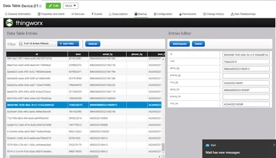

Best answer by PaiChung
You can actually find the mashup example shown in the top picture, duplicate it and see how it is 'wired' up.
It is a System mashup so you'll have to make those visible.
DataTableMashup and DataTableEditor

Thank for support, i'm research with that keyword and finded some solutions.
but i can't see how it wired up.  How can i do for see it?
