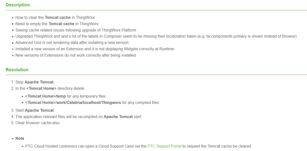

Hi @svisveswaraiya_285988
Thank you for contacting PTC.
If you mean clearing the browser cache, then refer to @tdixit @ reply.
If you mean clearing the Apache cache, then refer to https://www.ptc.com/en/support/article/CS238915
Just in case, you cannot log in to this URL, I will paste the content here
BR,
Max
