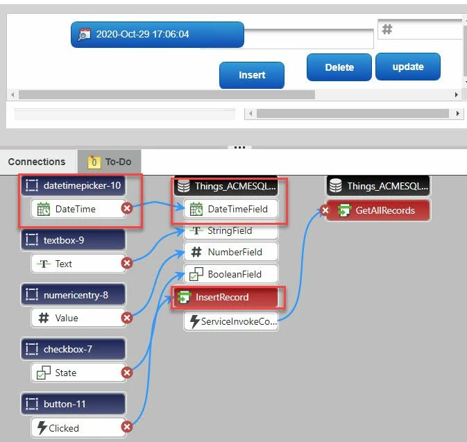

Hi, hoping you're doing well
I'm pretty new with thingworks and some functionalities still confuses me...
I need develop an aplication that:
- select a date range (I didn't see a Calendar Widget) and pass it to a service to make a query and get the results from db
- from a service read data from db and fill a List
  - from the selection of the list execute a query to read data from db
- from a service read data from db and fill a Graph
Also I need to manipulate de data from the query (make some calculations) and show them in the mashup
If you can give a coding example (or several) i'll appreaciate it.....

Best answer by jman87
@MM_9665428
Please refer below:
[comment] Date time Picker widget or Time Selector widget are related with date range.
Below I have selected the datetime as the input parameter value of my "InsertRecord" service in order to insert an entry to database (bind data time picker widget with input parameter "DateTimeField" > "IndertRecord" service). You may refer it to make a query and get the results from db (sure you need to create some *GetRecordBasedOnTime* service):
Refer my latest reply on https://community.ptc.com/t5/ThingWorx-Developers/store-the-SQL-result-in-a-Datatable-entity/m-p/695217/highlight/false#M48694
Best Wishes!
Teresa
