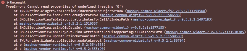

Good day! I have a bit of a problem with a specific setup - I have a list of changelog versions (just strings, 0.1.0, 0.1.1...) and from that selection, I load in the corresponding infotable of release notes. This works perfectly fine as long as you use it normally, but if you rapidly switch between list items, you get the following error in the developer console (note: no error on Thingworx' side):
From that point on, you can still swap between the list items, but no more services are executed and the displayed collection does no longer change.
Any help with this would be greatly appreciated!

Aug 7, 2024 8:57 AM UTC
You haven't specified which TWX version you are running, nor which widget you are using.
From the log though it appears you are using TWX 9.5.2 and the BMCollectionView from https://github.com/BogdanMihaiciuc/BMCollectionView
This widget is not supported by PTC and I would advise to log an issue on the github.

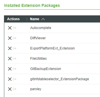

Thank you for the information! I did raise an issue in the Github, but I'm not sure that's actually something we did?
Checking our installed extensions:
I don't see the BMCollectionView on there and we're using the "normal" Collection widget in the actual Mashup from what I can tell.
Rocko
Aug 7, 2024 11:28 AM UTC
In that case, try to create a new mashup just using the OOTB collection widget and reproduce the problem. If you can reproduce, log a case with support.
