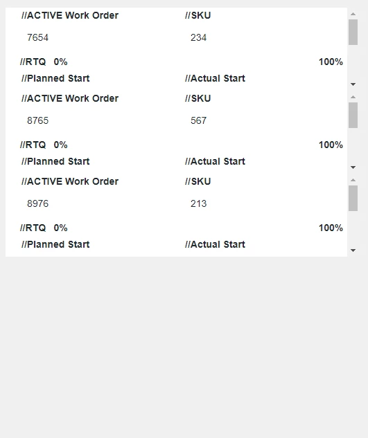

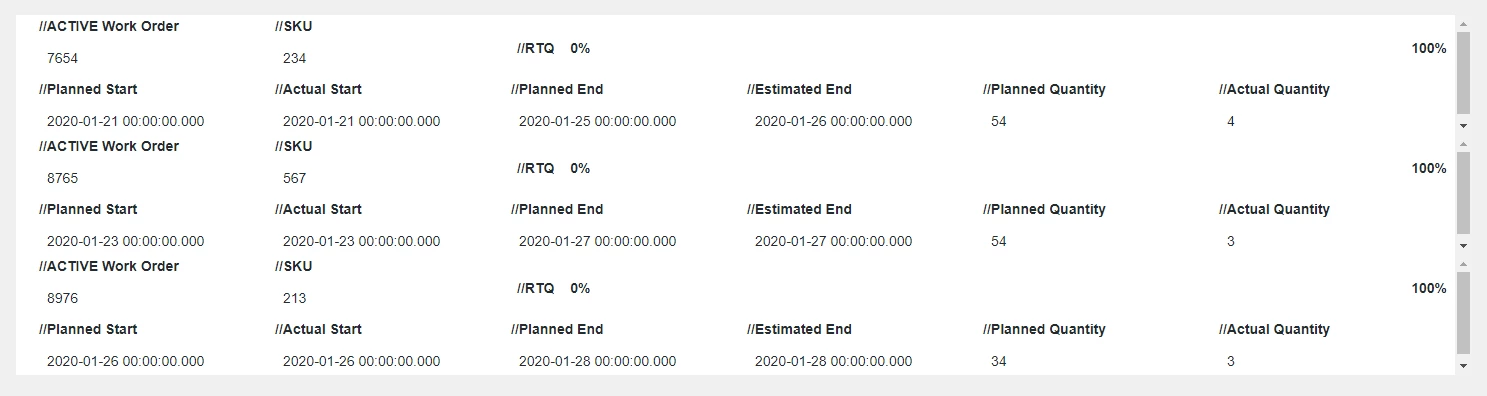

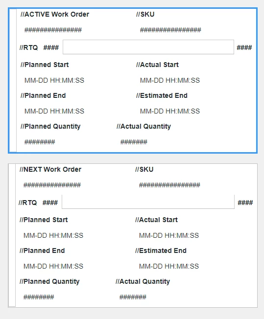

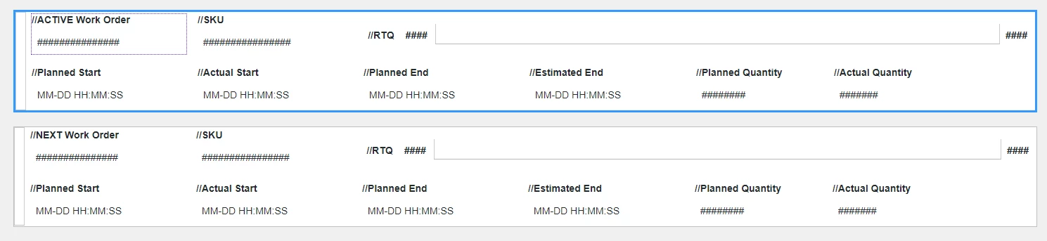

I have a Collection widget set as Table (view), so the repeated mashup fils the whole row. The repeated mashup is advanced/new responsive. I created it such a way that the height of the mashup extend according to the warped widget and containers (yes, containers warp by extended the height without scrolling, thanks to CSS addition). Because of this, when my row get thiner, the mashup warps well but the height of the row stays fixed and a scroll is displayed. I want my cell to be automatically extended with the height of the mashup (the thiner it is, the higher the cell should be).
I tried to use the CellHeightField to have a flex height. I noticed that only number is accepted. For example, if I put in the field "200", it is consider as 200px. If I put "200px", the collection displayed nothing. I tried 100%, also doesn't work. I also tried "max-content" (it works in CSS like "height: max-content;") but not taken in account.
So I tried to see the CSS of the collection and change it on runtime, I didn't find a way to make it flexible.
Does anyone have an idea? In CSS work around?
4 screen attached to understand the result: 2 with containers directly in the main mashup (expected result), 2 others with the collection widget

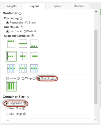

One idea is to make the container that has Collection as responsive, Strech.
Select in Explorer tab the container, go to Layout tab and select Strech:
Please let me know if this is making a difference or not.
